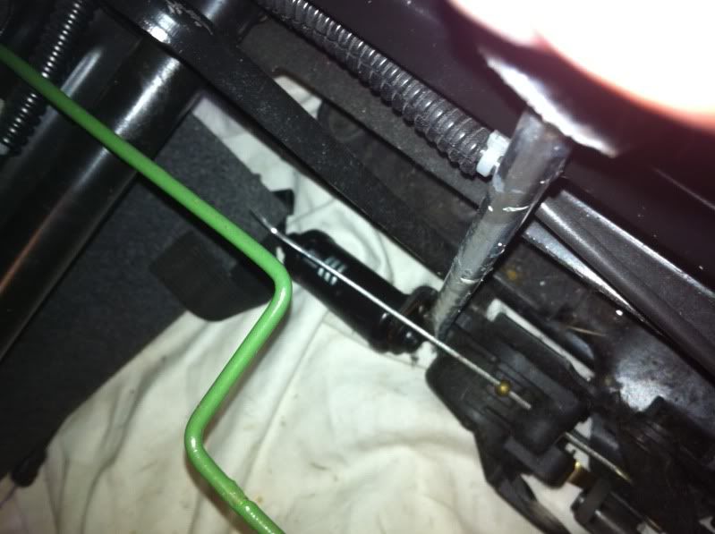

The tilt/slide mechanism works by a cable thats attached to the seat back, when the seat back is tilted forward the cable pulls on the mechanism under the seat base and releases it, allowing the base to slide.
On both seats the cables had snapped.

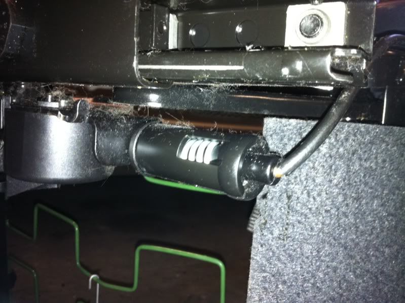

Layout of cable under the seat base

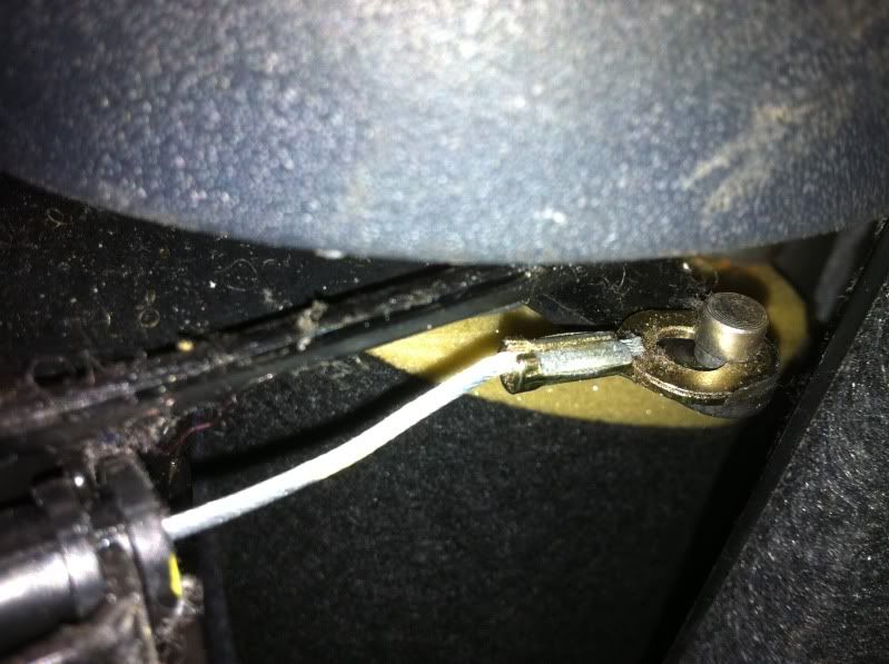

Cable holder at back of seat

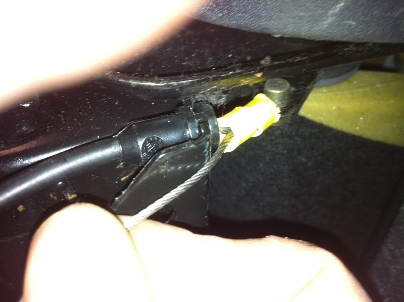

Cable attachment at base of seat back
Remove the cable shroud from the holder by levering out with a screwdriver
Next lever out the other end from the seat base

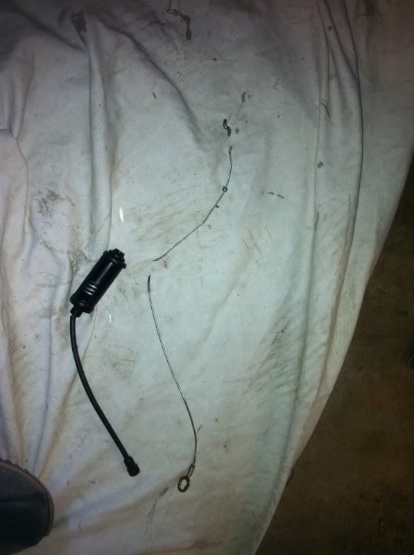

Cut the end off the old cable where it attaches to the mechanism

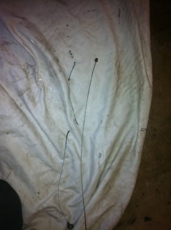

Layout of the parts and showing the broken cable

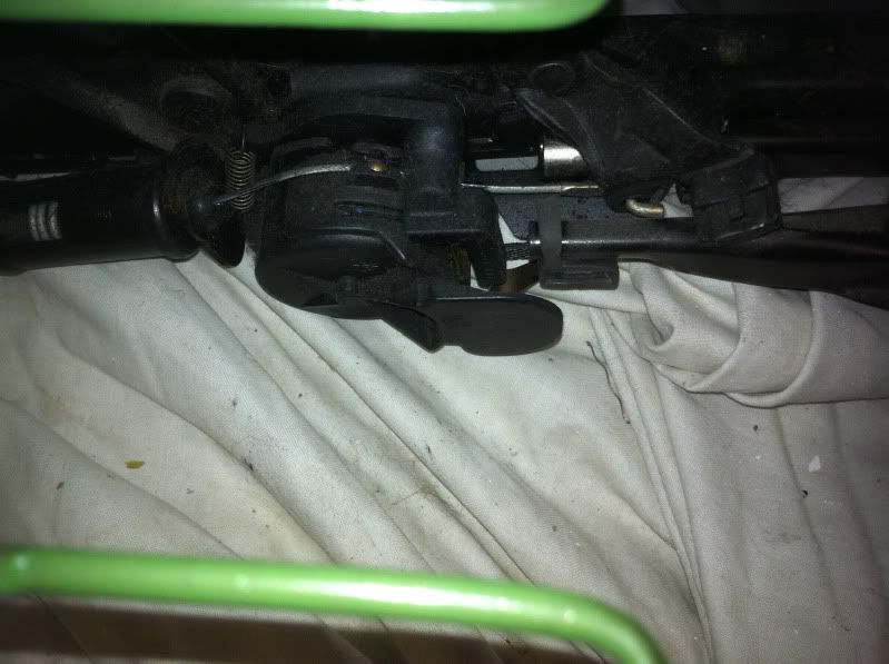

I used a length of new cable I had but a replacement bike brake cable would do the same job, this shows the replacement cable complete with nipple on the end

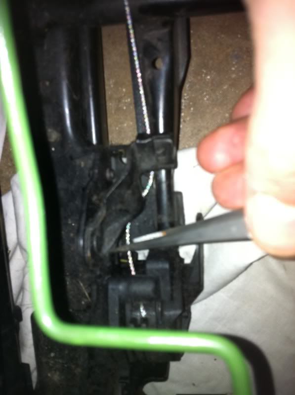

Feed the new cable through the hole in the metal bracket on the seat base and up through the mechanism
Next a small crimp needs to be fitted that locates in the plastic housing, I used electrical connectors as shown with the smaller blue one cut down and crimped onto the cable
Push the crimp into the housing then feed the new cable into the outer plastic cable shroud and clip the shroud in place onto the seat base and seat back.
Next pull the cable taught, fit the bigger crimps but keep the plastic outer on so the crimps retain there shape, loop around the lug on the seat back bracket and crimp in place.
