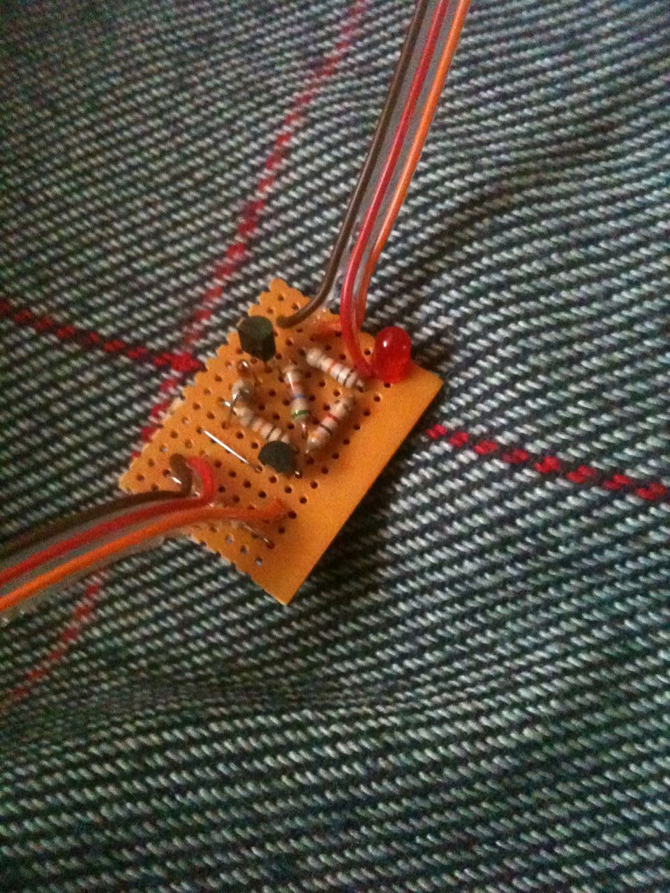

It plugs into the CD changer connector. The circuit for the interface is given in a help file within the program, it's a couple of transistors, five resistors and a diode.
