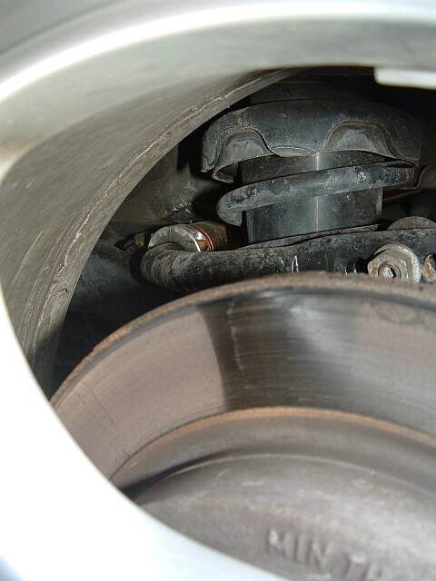

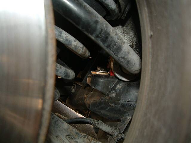

Here's some pics of my RDR bar installed:
