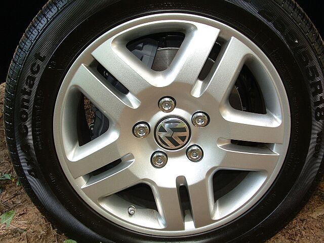

Our Touareg has 13"x1.25" (330 mm x 32 mm) but I don't think they'd fit on my MINI.
