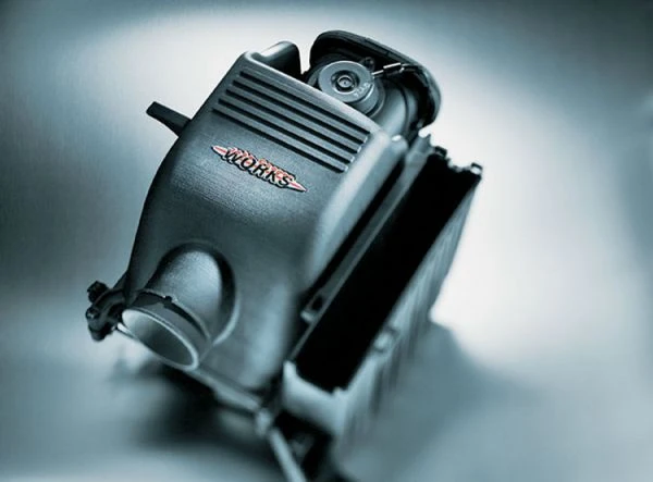

as part of the upgrade kit it says they upgrade the air filter does anyonw know with what or how

The air box in the JCW Upgrade Kit replaces the standard air box. Aside from having a cone filter, it also has a ECU-connected control unit which, at 4500 rpm, opens a "flap" at back of air box allowing extra air flow from cowl area, and making the supercharger whine more audible in the cabin.
The most important part of the Upgrade Kit is the larger fuel injectors and the ECU remap for them.

i have a 2003 so dont have a upgraded air filter then?

Does the airbox have a JCW logo on it?

no

Then your car has the 200bhp JCW Tuning Kit.

ok thanks so a good panel filter will help then
