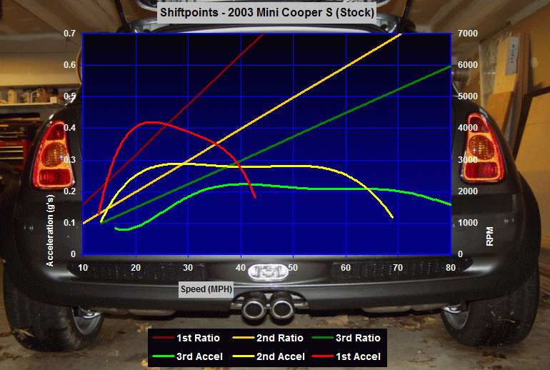

I did a bunch of testing with my stock MCS with results like this:

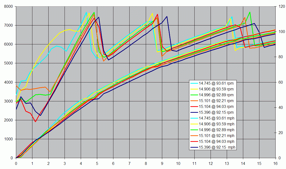

Then, once modded, I did a bunch of testing at the dragstrip. Here's some results:
The moral of the story is, slip the clutch and/or spin the tires at launch AT LEAST 3k rpm, then take it to the rev limit in every gear. Gear spacing on the MCS is such that shifts at redline (or close to it) are fastest.
