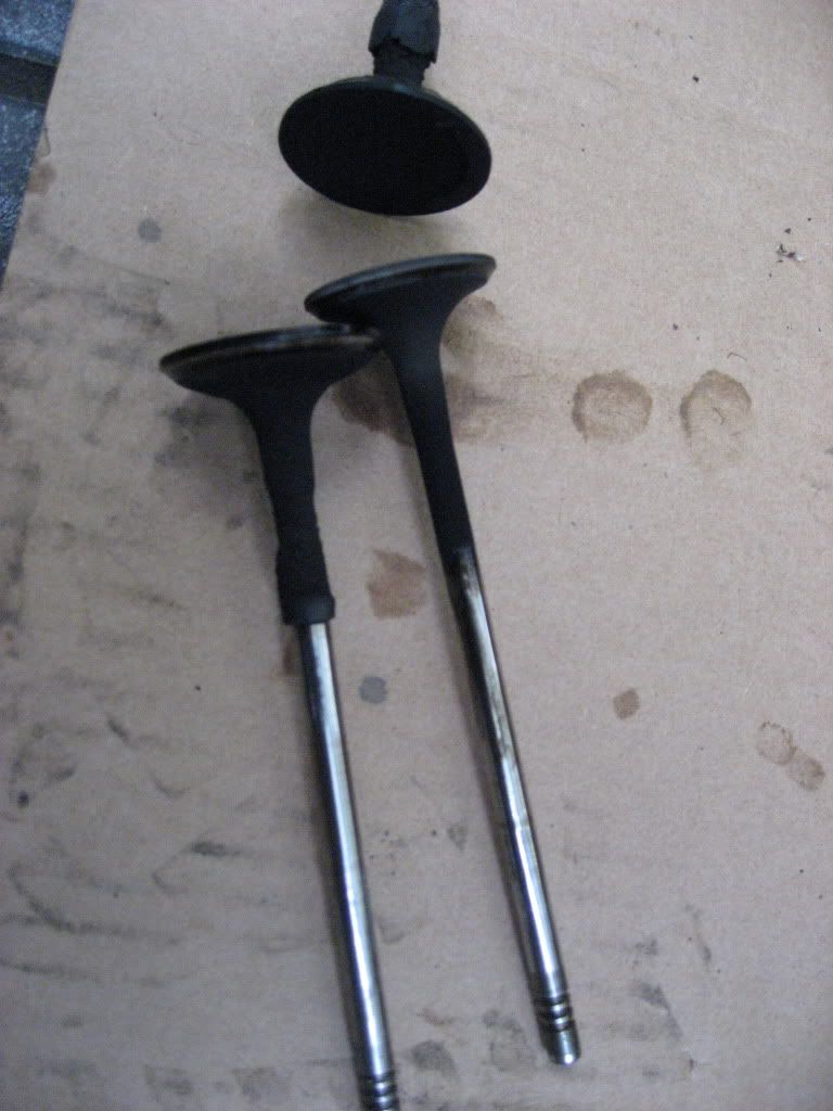

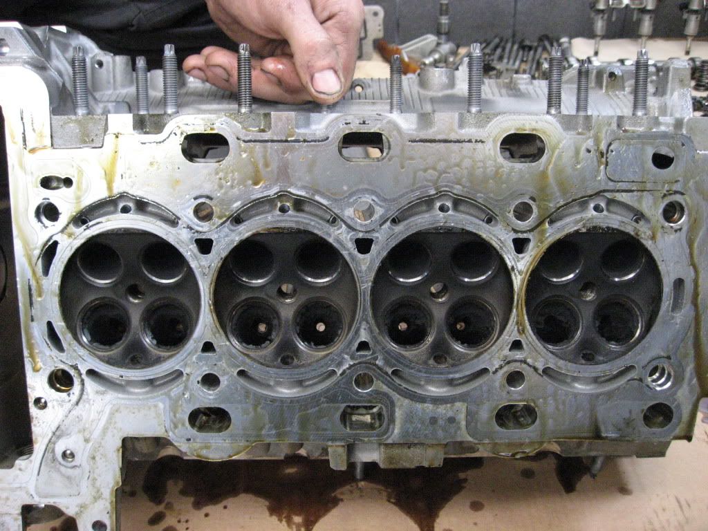

My car is currently undergoing decarbonisation - the dealership reckon it is a mixture of cheap fuel and driving style (I use it for Driving Instructing) that has caused it to clog up around the valves.
[IMG][/IMG]
But the thing is - this also happened on my previous engine (which was replaced under warranty due to excessive oil use) which was then cleaned under Warranty.
The first engine was decarboned at 20k miles the new engine is now on 50k miles.
Any thoughts or does it sound familiar to anything you've had?

They said driving style (me using it for driving lessons) and low quality fuel was the cause
I guess 7 hours a day driving gently then in between that me driving flat out wasn't enough to shift any gradual build up - as you can see its "caked" on hard!!
What I don't understand is - if the fuel doesn't go through the inlet valve anymore in these GDi engines (gasolene direct injection - because its directly injected into the cylinder) how come there is a build up on the outside of the inlet valve where only air comes through?
is it maybe breathing hard and taking oil back round and that's actually the build up?

There's been quite a few complaints about excessive carbon build-up in the North American Motoring forums, here's a couple of long threads discussing it:
MINI COOPER :: North American Motoring - Excessive carbon build-up in engine
MINI COOPER :: North American Motoring - Maintenance :: How-To do Seafoam Treatment R55/R56
When I had the cold start rattle fixed, they mentioned I had significant build up as well, and did the cleaning as a warranty service. They didn't mention that it was related, but they also replaced the valve cover at the same time- turns out that the old version allowed excessive oil vapor through the PCV system. If I remember correctly, the newer valve cover started showing up in new builds around March 2009.
Most theories at NAM attribute the build up to the valve cover, DFI (and the lack of fuel in the intake to wash the backside of the valves) and the long time between oil changes.

Some of the guys on NAM are right in that, the positive crankcase ventilation (pcv) valve allows this contaminated gas back into the air intake as it is designed to do, however over time this valve can become sticky and/or clogged from heat and oil degradation, this can then lead to very very fine droplets of oil finding their way into the air intake, this then settles in the intake runners and on the back of the inlet valves, with nothing to wash the intake runners and the back of the valves (fuel) then the fine oil deposits are subject to huge amounts of heat (with no fuel wash) and subsequently this then over time builds into the carbon.
