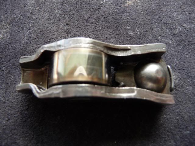

More the case of, the timing chain jumped a tooth on the crankshaft sprocket, thus causing valve to piston contact, which in turn broke the rocker arm, then through lockup, broke the chain, or, the timing chain did actually break, resulting in valve to piston contact, which then also broke the rocker arm, if the valve assembly is checked by a competent engineer, there will be tell tail signs, as to what the exact cause of the fault was.
Remember Mini have a regional area technical engineer, who you can ask to oversee your case, as he has more say than the dealer!

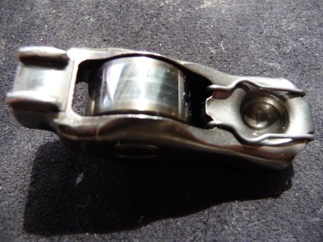

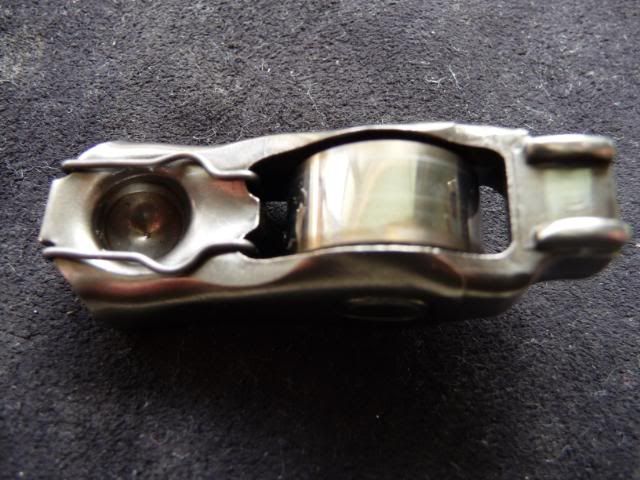

And here is a roller rocker arm from one of our valve train assemblies, and under normal circumstances, there is absolutely no way, one would fail, as indicated by your misleading with poor knowledge dealer and telling you *ull*hit, they are very very strong indeed, and produced by one of the best valve train component manufacturers, that the OEM factories use.
