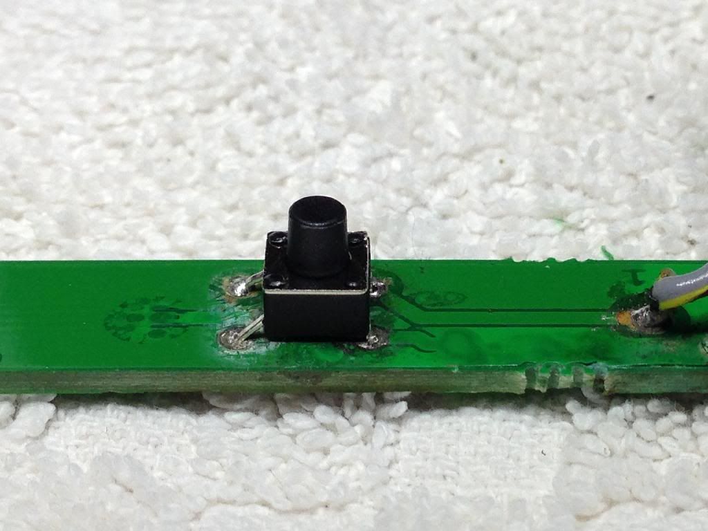

I just purchased a 2010 R57 and have since found out that the tailgate will only open via the remote control and will not work via pressing the button on the tailgate itself.
There are plenty of posts about the reason for this being water ingress into the switch so I thought since I have to pay for whole new $100 or more part because of a $2 micro switch I will see if its fixable.
After removing the part off the boot lid I could here water sloshing around and there was plenty of water to be drained.
Attached are some picture of the muck in there and there is plenty of corrosion on the circuit board where it has started to lift in places so not sure how repairable it is and if bypasses are needed. It's too late now to go and buy a micro switch as the shops are closed, I will try to repair it tomorrow and upload some more pictures.
Has anyone attempted this before?

I noticed 2 things on mine:
1. It doesn't have the seal around the boot lid switch that I've seen mentioned in other place.
2. The switch circuit board itself was flooded with water and there was no way for this to drain as it was sealed, the only way for water to get in was from the top where the cable comes in.
burnstar is offline

I went and spent 95 cents on a replacement micro switch this morning and after to soldering and reparing part of the circuit board track I have a functional boot switch.
A liitle bit of liquid electrical tape for some water proofing
Now to see how long this lasts! but for now it beats the min $100 on a replacement part

Glad you got it fixed, mine is still working 10 months later even though the PCB had quite a fair bit of water damage.
