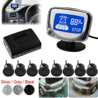

FYI, this is what I bought and had installed.... by a qualified electrical auto technician (only probelm is that he is Czech, I am English and neither of us speak the opposite language!)
Waterproof 8x Rear and Front View Car Parking Sensors + LCD Monitor - 3 Colors | eBay
Function: Rear&Front View Car Parking Sensors. - With 8 car parking sensor, protecting your vehicles and cars omnibearing. 8 Parking Sensor This product work like this, when you parking your car ahead.
