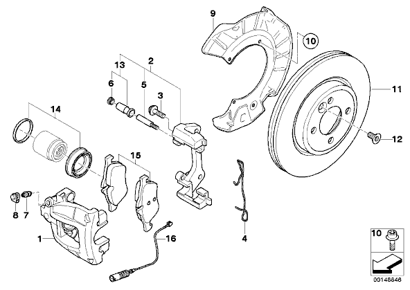

here is an exploded view of the front bakes
