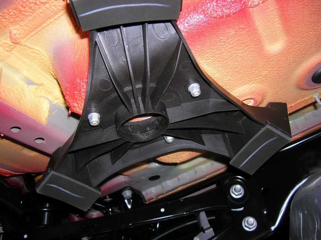

From the underside of the car, fix the final component with 3 plastic nuts to the studs.
Fit the 3 rubber bung buffers to the existing brackets on the underside of the boot floor.
Place the space-saver spare wheel over the plastic support assembly on the ground and position it under the car. Fit the lifting handle to the assembly through hole in the boot floor and pull the wheel up into position. You may find that you need to move the exhaust heat shield out of the way of the wheel. The wire spring clip holds the wheel up while you tighten the retaining nut with the wheel brace. This nut is the same size as the wheel bolts. (See also MINI Handbook for more details and pictures).

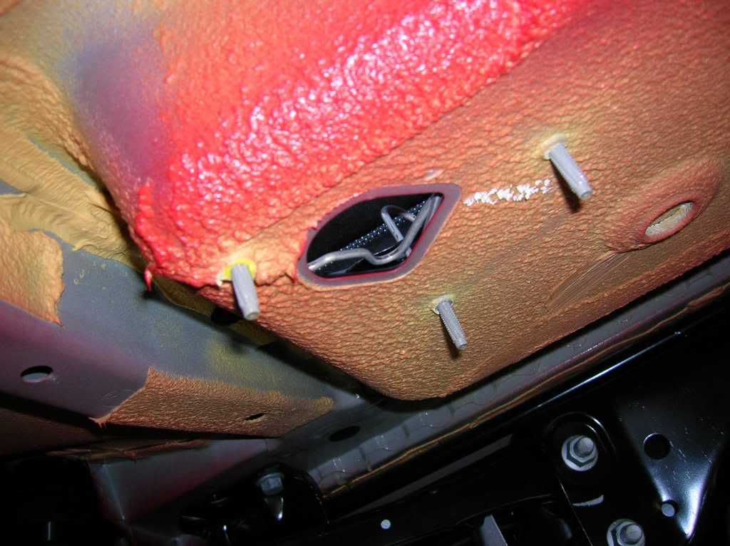

Grommet removed and retaining parts fitted
The studs have underbody protection foam on them that has to be carefully removed due to the studs being made of plastic
So, carefully cut the underbody protection foam and slide it off the studs, again, taking care not to damage the soft plastic studs
Attach upper part of wheel mounting to underfloor using the three studs protruding from boot floor. Only tighten just slightly more than finger tight "just nipped up" or else you'll strip the threads. Don't be alarmed, the weight of the spacesaver is NOT supported by these studs! Just treat the nuts as a retaining device and not something to be "tightened down" as such.
Attach long handle to spacesaver support, pull up through floor and allow spring catch to click into place.
Fit this cover, screw nut onto thread and tighten using wheel brace and the whole lot is supported.
