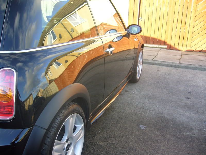

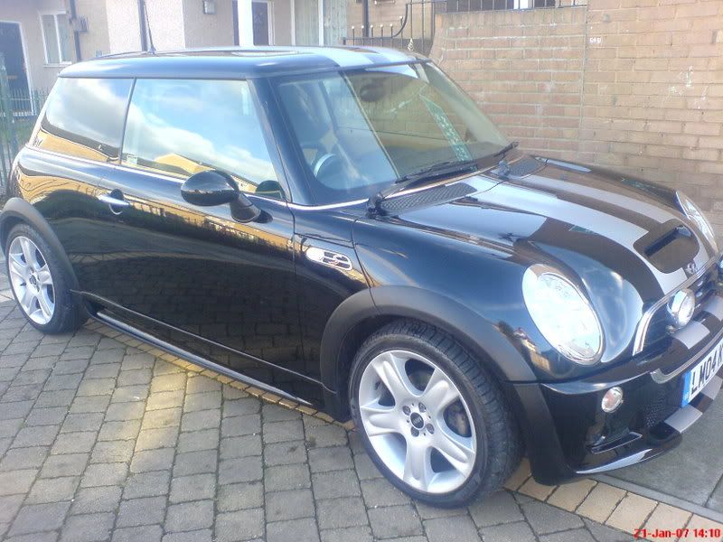

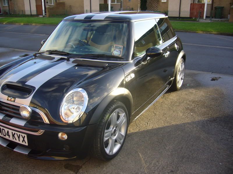

the stages for the interested were!
1, rinse with water and apply a pre rinse solution
2, wash the wheels with normal car shampoo while pre-rinse solution is soaking in
3, wash the car using 2 bucket method with turtle wax wash
4, sheet of with the end of the hose removed ( saved loads of time by sheeting)
5, dried using microfibre towels
6, used SSR2 with a silverline rotary polisher and a blue compounding pad
7, SRP applid with megs applicator pad
8, buffed off with microfibre towel
9, applied Natty's Blue wax with Megs app pad
10, buffed off with MF towel
11, used Back to Black on the trim and wheels
#39 ·
Your MINI is looking nice! Love the shine that Nattys blue gives to dark paint (thats what it was created for :) ). What i would say though is for the trim get some Poor Boys Trim restorer. I dont find back to black at all worth while as it only lasts untill it rains (hopefully it worked for you though :) ). But the PB TR is great stuff, leaves them really black and lasts!
